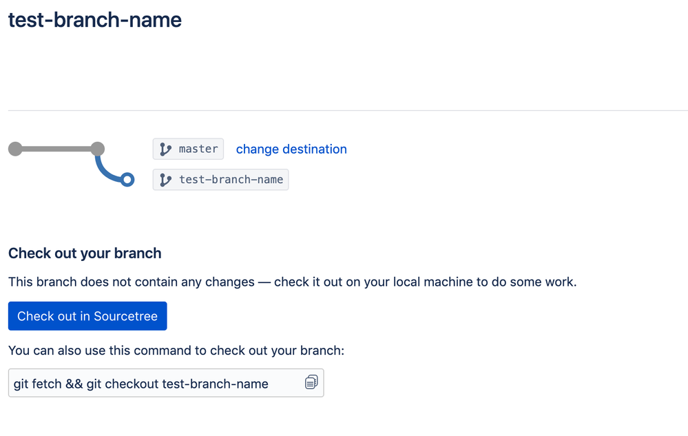

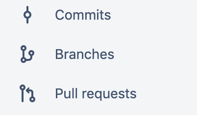

I then click on the Branches sidebar icon.

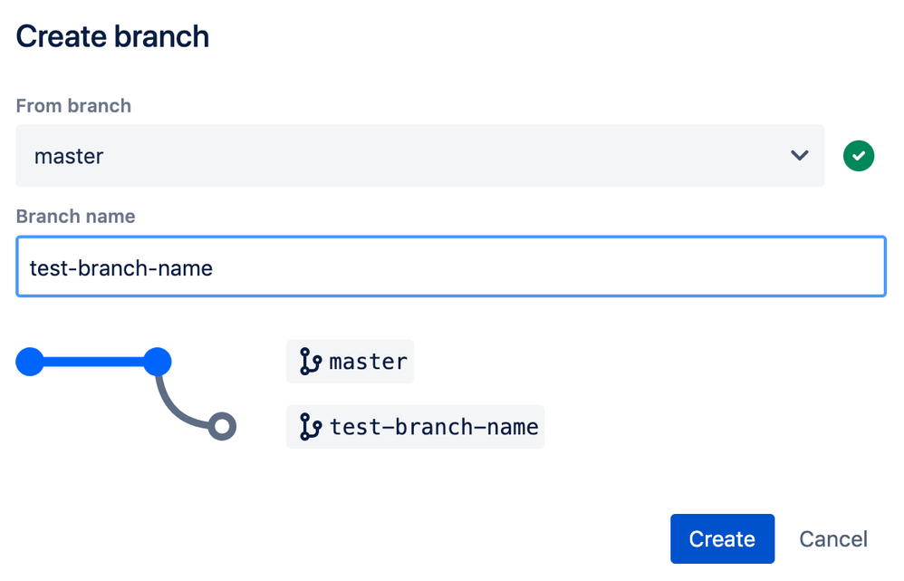

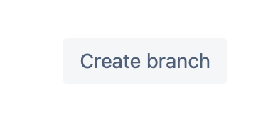

And then 'Create Branch'.
I call the new branch "test-branch-name".
Screen Shot 2019-04-11 at 6.35.17 pm.pngScreen Shot 2019-04-11 at 6.35.30 pm.png

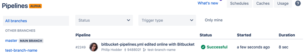

And then see that a new pipeline is running on that branch.
Does anything there look different to what you're doing?
