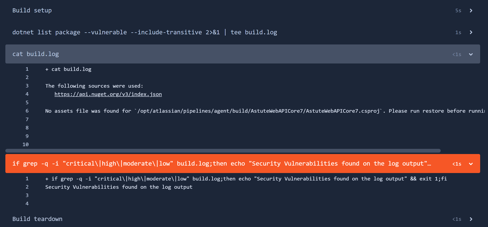

DavidL
July 10, 2023
Hi Patrik
Thanks for the response, it still does not work, there is also an error when trying to get the assets file on the packages along with it still erroring run the grep command, it does not seem to show an error on the grep command however?
Patrik S
July 13, 2023
Hey @DavidL ,
This error seems to be specific to dotnet. The documentation you shared in the questions states that a dotnet restore is required before the dotnet list package command. You can include that dotnet restore command as the first command in the pipeline step and verify if the issue is solved.

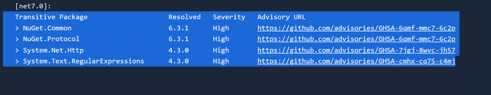

DavidL
July 13, 2023
Thanks, I now have the dotnet vulnerability check working at least, however it is actually reporting issues with the dotnet docker image/dot net sdk, which is the latest one!
