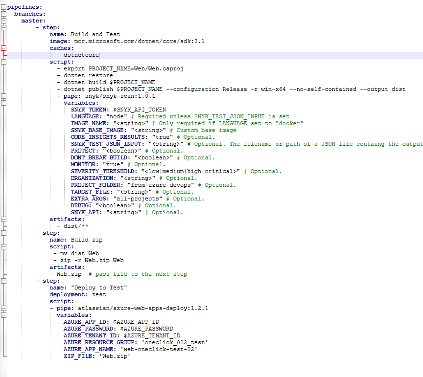

Can someone please help me with building dotnetcore api app and deploy on Azure?
This is what I have so far.
# Template .NET Core build # This template allows you to validate your .NET Core package. # The workflow allows running tests and code linting on the default branch. # To run your pipeline on a Windows machine, create a self-hosted Windows runner. # For instructions on setting up a Windows runner, see https://support.atlassian.com/bitbucket-cloud/docs/set-up-runners-for-windows/ image: atlassian/default-image:2 pipelines: branches: master: - step: name: Build and Test image: mcr.microsoft.com/dotnet/core/sdk:3.1 caches: - dotnetcore script: - export PROJECT_NAME=Web/Web.csproj - dotnet restore - dotnet build $PROJECT_NAME - dotnet publish $PROJECT_NAME --configuration Release -r win-x64 --no-self-contained --output dist - pipe: snyk/snyk-scan:1.0.1 variables: SNYK_TOKEN: $SNYK_API_TOKEN LANGUAGE: "node" # Required unless SNYK_TEST_JSON_INPUT is set IMAGE_NAME: "" # Only required if LANGUAGE set to "docker" SNYK_BASE_IMAGE: "" # Custom base image CODE_INSIGHTS_RESULTS: "true" # Optional. SNYK_TEST_JSON_INPUT: "" # Optional. The filename or path of a JSON file containg the output from running a test with the Snyk CLI (with json output option). PROTECT: "" # Optional. DONT_BREAK_BUILD: "" # Optional. MONITOR: "true" # Optional. SEVERITY_THRESHOLD: "<low|medium|high|critical>" # Optional. ORGANIZATION: "" # Optional. PROJECT_FOLDER: "from-azure-devops" # Optional. TARGET_FILE: "" # Optional. EXTRA_ARGS: "all-projects" # Optional. DEBUG: "" # Optional. SNYK_API: "" # Optional. artifacts: - dist/** - step: name: Build zip script: - mv dist Web - zip -r Web.zip Web artifacts: - Web.zip # pass file to the next step - step: name: "Deploy to Test" deployment: test script: - pipe: atlassian/azure-web-apps-deploy:1.2.1 variables: AZURE_APP_ID: $AZURE_APP_ID AZURE_PASSWORD: $AZURE_PASSWORD AZURE_TENANT_ID: $AZURE_TENANT_ID AZURE_RESOURCE_GROUP: 'oneclick_002_test' AZURE_APP_NAME: 'web-oneclick-test-02' ZIP_FILE: 'Web.zipimage.png

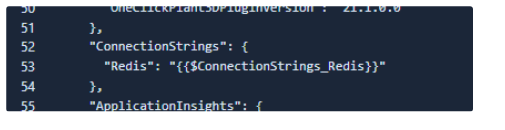

I got deployment working. Now I am trying to figure out how to send deployment variables. Do you have any idea?
For example - I am trying this but it does not set the value of the variable.
- step:
name: Build Web zip script:
- cd wwwroot # go into the folder
- contents="$(jq '.ConnectionStrings.Redis = "{{$ConnectionStrings_Redis}}"' appsettings.json)" && \ -
echo -E "${contents}" > appsettings.json
- cat appsettings.json
- zip -r Web.zip . # build a zip file for contents and their subfolders to avoid main "wwwroot" within the zip file
- mv Web.zip .. # move out the zip file so it can send to next step as artifacts
artifacts:
It is replacing as shown below:

Could you try to export the file as an artifact and open it locally?
See if the variable has been passed correctly because you won't be able to view the variable on Bitbucket Cloud Pipelines build UI if the variable is secured for security reasons.
