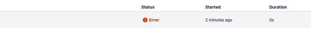

When I am adding additional steps to an existing pipeline, build just fials with status "Error" with no futher information as to why it is failing.

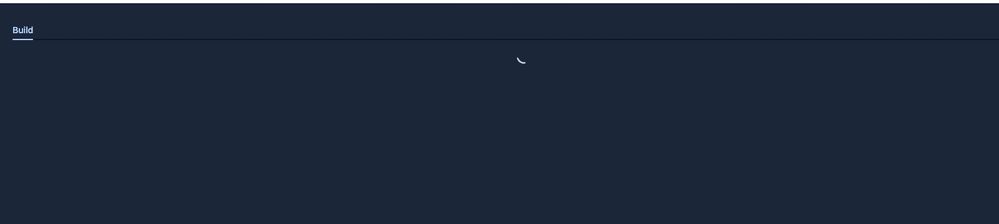

Build time is "0s" and opening the result leads to an infinite loader with a blank screen.
If I comment one of the steps, things work fine.

Pradeep Vanga
January 11, 2023
wow, this is really bad.. the issue is that I am setting the deployment: test to use the env specific variables in these steps.. turns out it is not supported
https://jira.atlassian.com/browse/BCLOUD-18261
UI wasn't showing any feedback, I had to go through the request, and responses in browser console to see the actual error. I spent hours trying various combinations to understand why things are failing sometimes even though everything looks correct.
