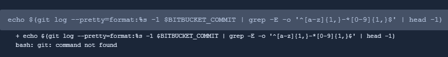

OK. Again, keeping in mind this is my first-ever pipeline, I commented out the pipe and just tried to echo out the value of what the regex should return, but it's giving me a command not found error on "git". Do I need to somehow make sure that git is installed on the docker image?
(The regex does match what I'm looking for when I test it here against some of our ticket number formats (any number of letters, a dash, any number of numbers).

Yes, you need to make sure git is installed so the command can succeed. You will need it to get the commit message.
I tested this command using the default docker machine atlassian provides when you don't specify a specific image.
