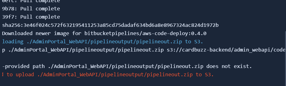

Omkar posam
January 5, 2023
 @Jimmy Seddon Please help me out of this , I have deadline to meet. This error is poping out for any path I give even which you specified . I checked with ls and pwd to confirm the build and zip everythings right .

Omkar posam
January 5, 2023
Hi please someone help me out @bitbucket
Igor Stoyanov
January 6, 2023
@Omkar posam hi. You have to understand where you put your artifact.
Under your script check where you are (add some ls command to debug):
script:
- cd AdminPortal_WebAPI
-ls -la
- apt-get update && apt-get install -y apt-utils
- dotnet build --configuration Release -o AdminPortal_WebAPI/pipelineoutput
- cd AdminPortal_WebAPI/pipelineoutput
- ls -la
- apt-get update && apt-get install --yes zip
- zip -r pipelineout.zip . -i AdminPortal_WebAPI/pipelineoutput/.* *
- ls -la
Then properly store you artifact. Here some example:
script:
- apt-get update -y
- cd admin/front-end/ -- you are in admin/front-end folder
- npm install
- CI=false
- npm run build
- apt-get install -y zip
- zip -r myapp.zip * -- you created zip under admin/front-end folder
artifacts:
- admin/front-end/myapp.zip -- you store your artifact
- step:
name: Upload to S3
script:
- pipe: atlassian/aws-code-deploy:0.2.3
variables:
COMMAND: 'upload'
ZIP_FILE: 'admin/front-end/myapp.zip
Regards, Igor
