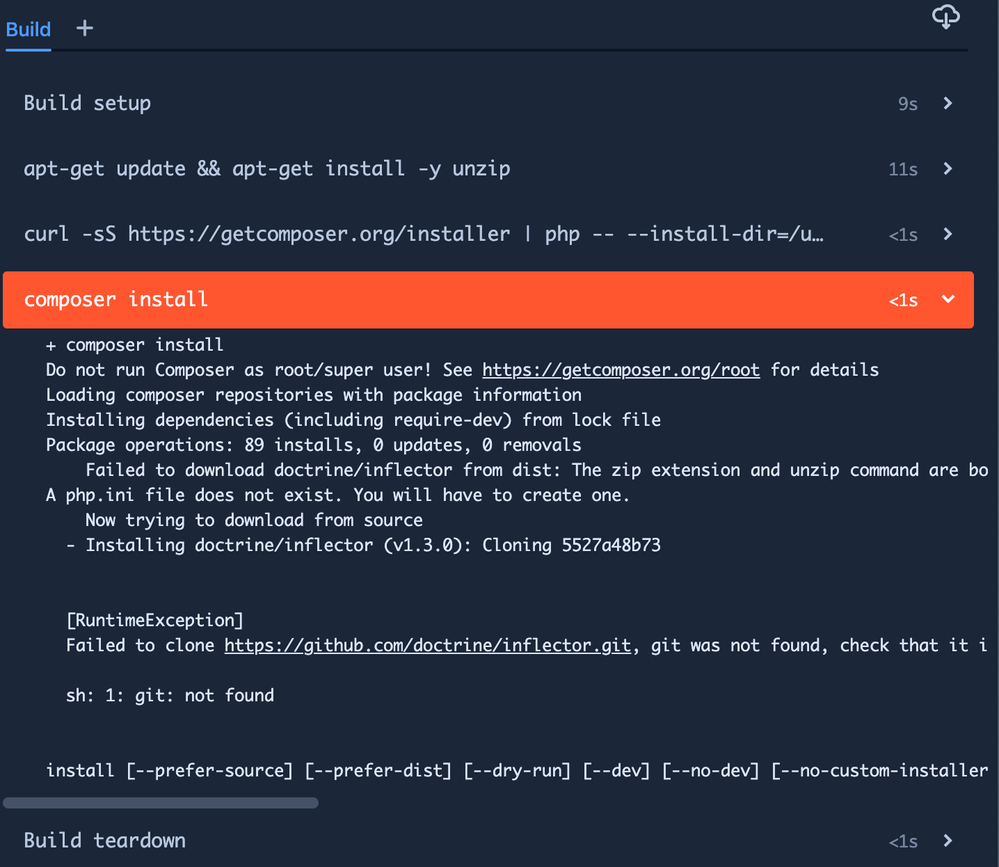

I have a Laravel+Vue SPA, and deployed it through Forge, and used Digital Ocean and Bitbucket for this. Now my pipeline was working properly few months ago, and now I am getting a Failed status when I try to commit and push. Here's the error that I am getting:
Any idea what's going on here?
Thanks in advance for the help.

Hi @byfreo,
it looks like Git is required by Composer installer and is not available. This could be because this is a new requirement from the Composer Installer - or (less likely) git was remove from the Docker image you're using.
You could try installing Git, similar to how you're installing unzip: `apt-get install git`
