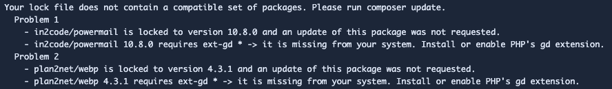

I am using deployer to deploy my TYPO3 project on the server. Since today I am getting this error: ERROR: Task deploy:vendors failed!
I changed absolutely nothing in my pipeline since the last time.
I get these informations:Bildschirmfoto 2024-04-30 um 14.50.51.pngI already checked, the php extension gd ist active for my domain: https://derkreiger.at/20240430_info.php#module_gd
Can anyone help?
Thanks and all the best,
Mylene

I tried to troubleshoot today. Started the local docker debugging and ended up with a different error. To ensure I reran the pipeline and there I am getting the same new error
[host25.ssl-net.net] bash: /lib/x86_64-linux-gnu/libc.so.6: version `GLIBC_2.38' not found (required by bash)
[host25.ssl-net.net] error in info.php on line 6:
[host25.ssl-net.net] exit code -1 (Unknown error)
done deploy:info 80s 432ms
ERROR: Task deploy:info failed!
task deploy:failed
done on host25.ssl-net.net
done deploy:failed 62ms
The same error occurs if I try to rerun a commit that already succeeded in the past. Any ideas?
Thanks & kind regards,
Mylene

Based on the error you posted here, it looks like the package GLIBC is missing from the Docker container where the build runs. I suspect that may be caused by either a change in the Docker image you use as a build container or a change in your project's dependencies.
I would suggest following the link to debug locally the last successful build (in the Dockerfile, provide the exact same image SHA from the last successful pipeline). If that succeeds locally, then the error has to do with a change in the Docker image. You can then pin the image by digest in the bitbucket-pipelines.yml file (you can pin to the digest of the last successful build):

the last successfull build doesn't work locally:
task deploy:lock
[localhost] run git config --get user.name
[localhost] run whoami
[localhost] root
[host25.ssl-net.net] run [ -f /.share_home/derkreiger_at/amitex/staging/.dep/deploy.lock ] && echo +locked || echo 'root' > /.share_home/derkreiger_at/amitex/staging/.dep/deploy.lock
[host25.ssl-net.net] +locked
[host25.ssl-net.net] run cat /.share_home/derkreiger_at/amitex/staging/.dep/deploy.lock
[host25.ssl-net.net] ci
[host25.ssl-net.net] Deployer\Exception\GracefulShutdownException in lock.php on line 14:
[host25.ssl-net.net]   Deploy locked by ci.
[host25.ssl-net.net]   Execute "deploy:unlock" task to unlock.
done deploy:lock 313ms
ERROR: Task deploy:lock failed!
I tried to rerun the same build in the pipeline and I get the same error. I am very confused... as you can see it is always a different error. How is this possible?
Kind regards,
Mylene

Assuming that you pinned locally in the Dockerfile the exact same image SHA from the last successful build, it doesn't look like this is related to the Docker image only. Considering the local failure, the issue is not specific to Pipelines either. I suspect there may have been a change in any of the tools you use during your build which makes the build fail now on that container.
I suggest reaching out to the support team or a forum specific to the tool you are using when you get this error for help with troubleshooting this. You need to have a build that works locally on a Docker container for it to work in Pipelines as well.
