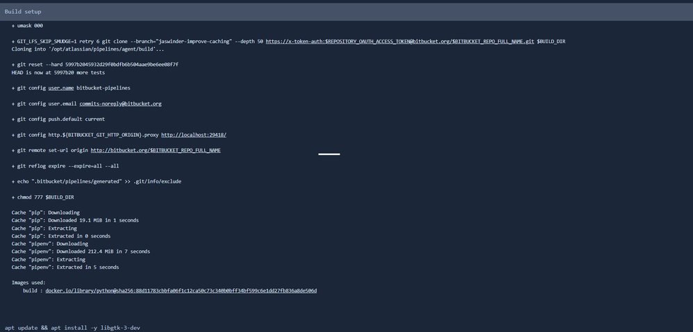

Here is the output from my build setup, where it is obviously pulling in the pipenv cache,

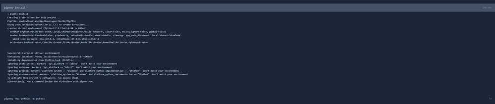

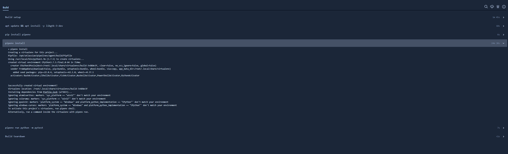

Here is the output of my pipenv install step:
Any additional guidance is greatly appreciated. Thanks very much!

From the build logs you have shared, the folder ~/.cache/pipenv actually had something, as it generated a 212.4 MiB cache file.
So the issue here seems to be that pipenv is not using that cache, or looking at somewhere else. In this case, this falls a bit outside of Pipelines scope, and is more related on how pipenv handles the cache, as pipeline is correctly generating the cache for the directory provided.
I would recommend you to test the cache itself by using a small repo with like 1 dependency to identify what it takes within pipenv to actually use the cache.
Additionally, pipenv documentation also provides an environment variable that you can use to change the cache location (PIPENV_CACHE_DIR). You can try changing the default directory by setting that environment variable, create a cache definition in your YML file for that same path, and check how it goes.
If it still does not work, I would say you could try using a different package manager, like pip, or try doing a deeper investigation on how pipenv cache works and which are all the folders it looks for, so you can cache all the required directories in your build.
