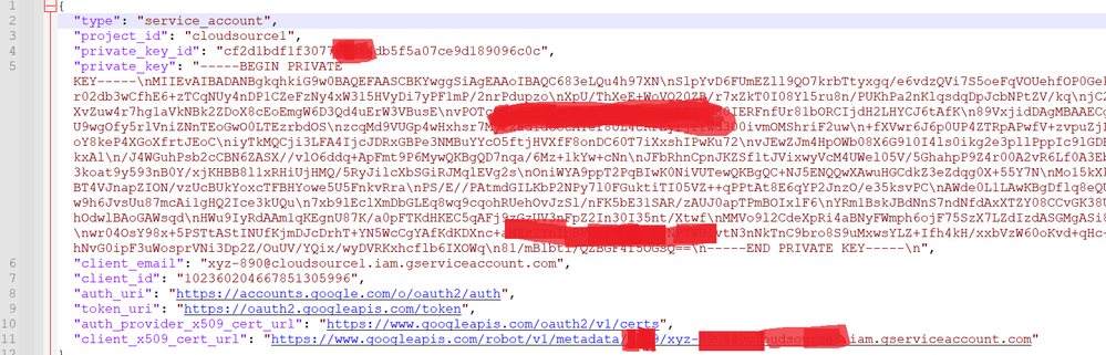

I am trying to setup CI CD with the help of GCP bucket. I Created a Service account and gave it storage object admin rights . I have added a variable as Key from my Service account  but when i run the pipeline it is throwing error during transfer process

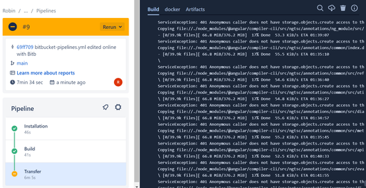

Error:
ServiceException: 401 Anonymous caller does not have storage.objects.create access to the Google Cloud Storage object. Permission 'storage.objects.create' denied on resource (or it may not exist)

Hello @Robin ,
Welcome to the community!
Based on the atlassian/google-cloud-storage-deploy documentation, it mentions the following about the $KEY_FILE variable :
KEY_FILE (*) base64 encoded content of Key file for a Google service account. To encode this content, follow encode private key doc.
So in this case, could you please confirm if you have base64 encoded the value of the private key before saving it to the $KEY_FILE environment variable ?
If not, you can use the following commands to base64 encode it :
Linux:
base64 -w 0 < my_ssh_key
Mac OS X :
base64 < my_ssh_key
Windows :
[convert]::ToBase64String((Get-Content -path "~/.ssh/my_ssh_key" -Encoding byte))
Then, save the encoded value as an environment variable named $KEY_FILE at either the workspace or repository level.
Let me know in case you run into any issues.
Thank you, @Robin !
Patrik S
Robin
February 23, 2023
Thank you so much now its working
