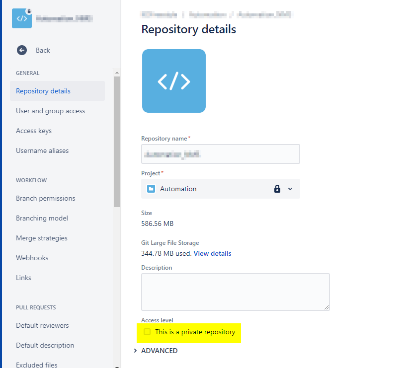

Problem:
I created a list of URL's to open my repos so auditing my permissions will be a bit easier.
Here's an example: https://bitbucket.org/<workspace>/<myrepo>/src/master/
When I open a repo with the above URL from a document, Chrome opens to the repo.
I then go to the "Repository Settings".
It shows the Access Level "This is a private repository" as unchecked which is not correct.
If I force a refresh of the page the Access Level "This is a private repository" now has a check in the box.
My concern is my repos may accidentally become public.
Is anyone else seeing this issue opening repo's this way?

sjamisorc
February 10, 2021
Thanks for the reply
The repositories avatars do have the lock symbol
The workspace and all projects are marked as private in the settings
Here's a screenshot of what I'm still seeing

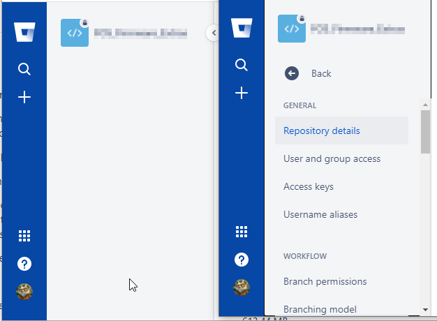

This link generated the issue consistently. Once the source view is open I then click on the repo settings and the Private option is unchecked but the repo avatar has a padlock symbol. The master branch does exist and is the default branch
     https://bitbucket.org/<workspace>/<repo>/src/master
This link does not generate the issue using the same workspace and repo
This variation of the url
    https://bitbucket.org/<workspace>/<repo>/admin
Causes the left menu to vanish.  Please see the attached image

- It is also a bit unclear to me what you mean with variation of the URL https://bitbucket.org/<workspace>/<repo>/admin
Selecting Repository settings should always open https://bitbucket.org/<workspace>/<repo>/admin
Do you see a different behavior/URL, depending on which page you are selecting Repository settings from?

sjamisorc
February 9, 2021
My workspace is set as private as well
If I select the checkbox to make the repo private again the Save Changes button does NOT activate.
