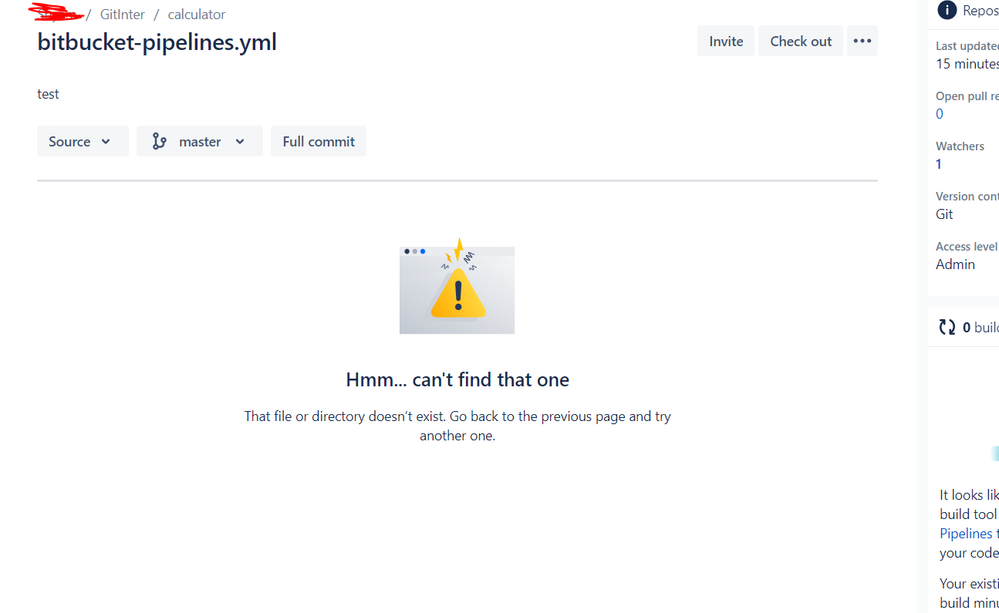

I have imported the repo from Gitgub to Bitbucket
https://github.com/soundd2/calculator

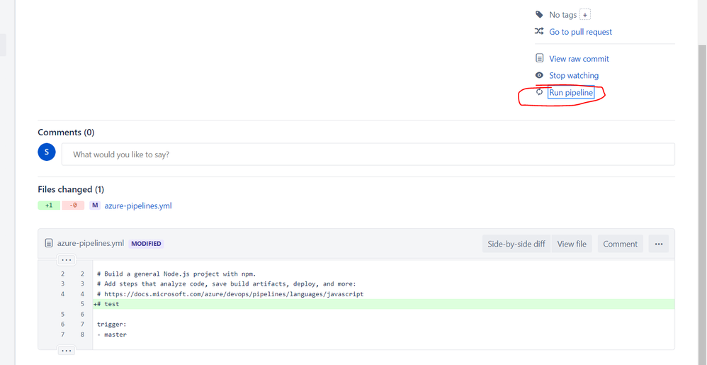

As soon as I imported and after opening the YAML file I am expecting to run the pipeline. Although I enabled pipeline from settings and done full commit I am not seeing any pipeline running. When I click on run below pipeline

Based on my observation you're trying to run the azure-pipelines.yml file on Bitbucket Pipelines, but unfortunately that's not supported. Bitbucket Pipelines has its own structure, thus we would like to suggest you to create the Pipelines under the bitbucket-pipelines.yml file. You can get started with Bitbucket Pipelines by following the steps here: https://support.atlassian.com/bitbucket-cloud/docs/get-started-with-bitbucket-pipelines/
