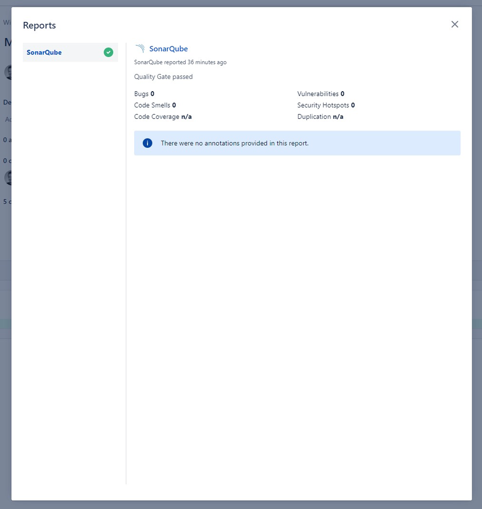

Maybe I'm missing something. I'm using 2 steps in the pipeline to analyze code, one to execute Cypress tests and the other one to run SonarQube analysis. SonarQube creates report in the Reports tab but Cypress doesn't. Is it because after Sonar Scanner performs the analysis and uploads results to SonarQube server, SonarQube server uploads the report to the BitBucket?

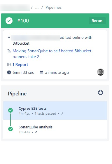

goran_ocokoljic
September 8, 2022
Hi Theodora,
It creates report both in pipeline build log and in reports panel of the pull request. I'm sending screenshots.

Theodora Boudale
September 9, 2022
Hi Goran,
Thank you for the info.
The reports I see in your screenshots concern reports created by our API, so yes, my assumption is that SonarQube uses our API to create these reports.

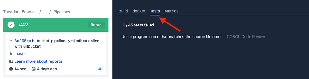

I am not sure how Cypress works, but if you don't see any Pull Request reports then it looks like no API calls are made to create such reports. I see in the step for Cypress the argument "mochaFile=./test-reports/test-output.xml", is that the file with the test results? If so, this report should show in the Pipelines build log in a tab named Tests, if the test results are in JUnit or Maven Surefire XML formats and if they include a fail, see an example below:
