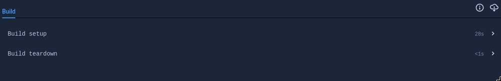

March 5, 2020
This is how it looks in the pipeline console.
This pipeline contained simple step: 'echo test'.
I can tell that all scripts are run as artifacts are created as well it can proceed to the next step

Regarding that screenshot you posted:
When you extend the "Build setup" section (and also the "Build teardown" section), what does it show?
I ask because I had a similar issue (like "no logs from script") and it showed an error message therein. Compare with the screenshot / infos in the question Pipeline Build Setup: /bin/sh: /usr/bin/mkfifo: not found.
It was with a different image (not ???/php-fpm:7.2 but docker.io/busybox) and I could resolve the issue with a little modification of the image. Your mileage may vary.
