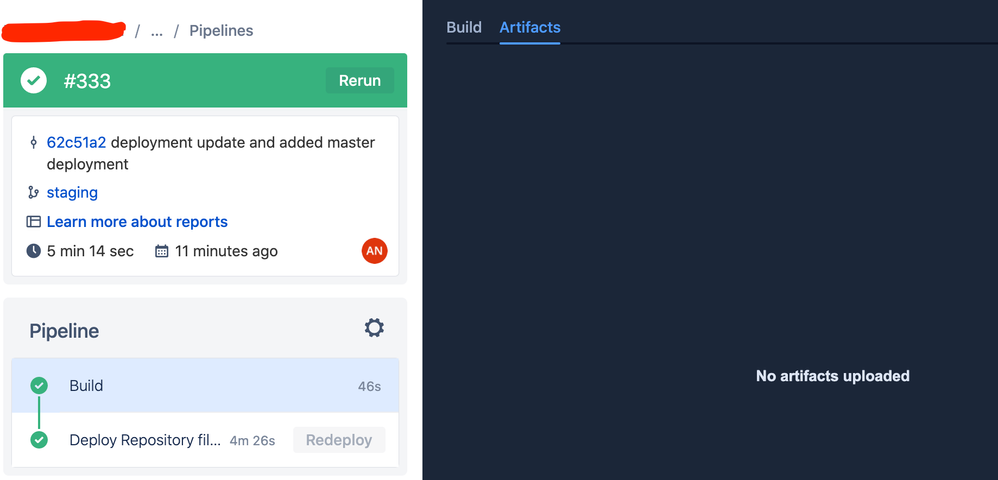

Hi everyone,
I created a bitbucket-pipelines.yml file and added a step in order to build frontend assets before transfering files to a server.
I cannot use rsync (pls don't ask why or recommend me using it. I just can't) and instead use scp.
But the problem lies within my build step, because it doesn't seem to upload artifacts which I then can transfer on my remote host system.
Here is a snippet of my pipelines file:
- step:
image: node:10.16.0
caches:
- node
script:
- cd front-end
- npm install
- npm i gulp -g
- gulp build --production
artifacts:
- public/dist/**
- step:
name: Deploy Repository files using SCP to Staging
deployment: staging
script:
- pipe: atlassian/scp-deploy:0.3.12
variables:
USER: '$DEPLOY_USER'
SERVER: '$DEPLOY_HOST'
REMOTE_PATH: '$DEPLOY_PATH_STAGING'
LOCAL_PATH: '$BITBUCKET_CLONE_DIR/'
DEBUG: 'true'
This is the output
What am I missing that my Build step can't seem to be able to upload artifacts?
Any ideas?
Best regards
Alex

Hi @Alex Nowak,
Welcome to the Community!
I'll admit that I'm not 100% familiar with BitBucket Pipelines as our company uses a Bamboo server.  However, we do use YAML specs for our build plan configurations and a number of things look similar.
Looking at the documentation for pipeline artifacts here:
https://support.atlassian.com/bitbucket-cloud/docs/use-artifacts-in-steps/
I see the statement: "Artifact paths are relative to the BITBUCKET_CLONE_DIR."
I know when I have been setting things up myself, this can be the bane of my existence as well.  My first thought would be to check and make sure that "- public/dist/**"
Is actually the relative path you are expecting to get artifacts from.  You could also test this by adding a second definition for a file that you know will exist in the root of the BITBUCKET_CLONE_DIR just to make sure that artifacts are actually being discovered and saved as a part of the build step.
Those would be the spots I'd start looking fist.
I hope that helps!

@Alex Nowak were you able to find a solution for this? I am also facing the same issue. Target folder has the artifacts but they are not being uploaded to the artifacts tab to be able to use them in next steps.
