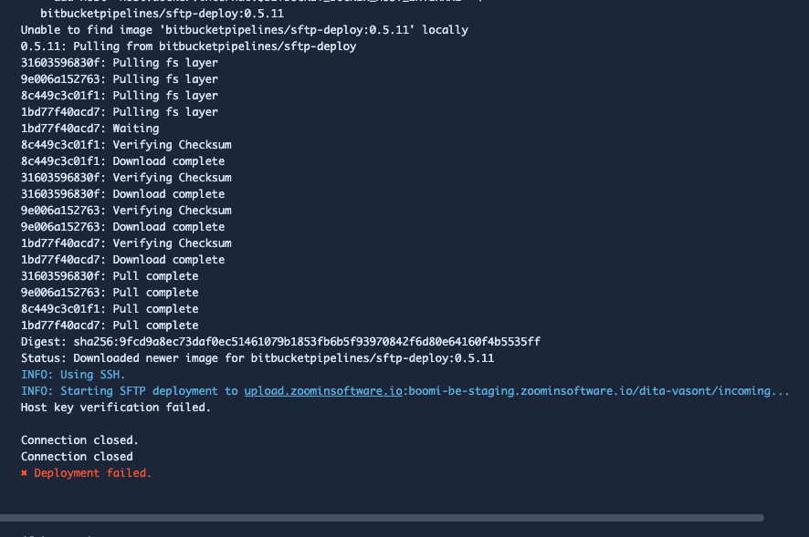

I had to add some stuff, to add zip functionality.

I am currently getting Hosting Authentication error. I made sure I put my private SSH key in the BITBUCKET_SSH_KEY_FILE repository variable. Got the same error. I made sure I did a base64 encode of my private key, then put THAT into the same variable. Same thing. When I pasted the private key with the linebreaks, I got a different error, so I know it is accessing the BITBUCKET_SSH_KEY_FILE.
I was able to sftp to that server and put a zip file in the desired location with no problem.
Is it possible that, the manner/encoding that BitBucket is expecting the private SSH key is not compatible with what server is expecting, and so it fails then?
Here is a screenshot:
Also should bundle.zip be saved an an artifact to be passed to the sftp pipe?

Hey Russ,
I have once again censored your output due to this being a public forum.
You will need to ensure that you generate an RSA SSH key with no passphrase using the following command:
ssh-keygen -t rsa -b 4096 -N '' -f my_ssh_key
Once complete, you will then need to encode the key in Base64:
base64 < my_ssh_key
Once done, you will then need to copy paste this into your repository variables.
After completion, you need to install the public SSH key on your remote server and add a my_known_hosts file to your Bitbucket Repo and commit it:
ssh-keyscan -t rsa server.example.com > my_known_hosts
A complete guide can be found here under "use multiple SSH keys in your pipeline":
https://support.atlassian.com/bitbucket-cloud/docs/variables-and-secrets/#Use-multiple-SSH-keys-in-your-pipeline
Please follow the guide above step-by-step. Once complete, please let me know if you run into any further issues.

Hi Ben,
my key was generated with
`ssh-keygen -t rsa -b 4096 -m PEM`
giving a `id_rsa` and `id_rsa.pub`.  This key has no passphrase. Is this format ok?
I have done the base64 encoding, but will try it again. Do both the private AND public key need to be base64 encoded prior to putting their values into the Repository settings>SSH key section?
My public key is already on the remote server, as I can sftp from the command line.
My `~/.ssh` directory has a `known_hosts` file. I will add a unique `my_known_hosts` file on the repo.
I will give this a try and let you know!
