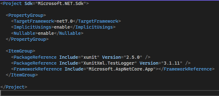

The project itself is a class library with the following .csproj:
I have attempted a few solutions I found online, primarily trying to add these two lines of code:
- <CopyLocalLockFileAssemblies>true</CopyLocalLockFileAssemblies>
- <PublishWithAspNetCoreTargetManifest>false</PublishWithAspNetCoreTargetManifest>
The 'CopyLocalLock...' line solved the previous error, but I got a very similar one instead:
"Testhost process for source(s) '../MyProject.dll' exited with error: Error:
An assembly specified in the application dependencies manifest (testhost.deps.json) was not found:
package: 'Microsoft.TestPlatform.CommunicationUtilities', version: '15.0.0.0'
path: 'Microsoft.TestPlatform.CommunicationUtilities.dll'"
I have not been able to find a solution for this one (the 'PublishWithAsp...' setting did nothing for me).
