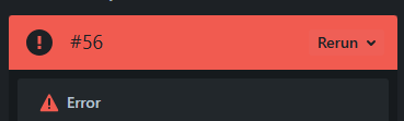

Thanks for your answer, Patrick!  This is helpful, although I did know most of this.  I'm not really getting far enough to troubleshoot most of that, however, because the pipeline isn't even getting started:
The text underneath reads "/Users/[username]/Desktop/MacOsRunner2/atlassian-bitbucket-pipelines-runner/bin/../temp/[runnerguid]/build".  Importantly, that should NOT be the folder that runner is running in.  It SHOULD be "/Users/[username]/Desktop/GitProjects/[projectname]/MacOsRunner/Runner1/atlassian-bitbucket-pipelines-runner/bin/../temp/[runnerguid]/build"
Sometimes, when it runs, that "MacOsRunner2" is a different number - generally 1 or no number there at all, simply "MacOsRunner".
