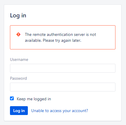

Also, what has prompted this move is us not being able to log in with LDAP - there is some communication issues here. I do have ssh access to the Linux server - are we able to bypass LDAP and log in with a system account? If so, how would we do that?

Bitbucket allows you to log into the application and authenticates against either an internal user directory or externally-managed user directories (e.g. LDAP, Crowd, etc).
You can't use the ssh credentials you have for the server itself to log into the application.

I understand that SSH/OS account credentials are separate from Bitbucket's user list. With me having root access to the system Bitbucket is running on - is there a way for me to access the following:
- Temporarily remove LDAP authentication or run both LDAP and system accounts side by side?
- Change the local administrator's account for Bitbucket, not the Linux system itself?
Ultimately if I'm able to bypass LDAP, use a system account and log into Bitbucket's GUI i would feel much better about starting the migration to the cloud.

The original administrator account used to configure Bitbucket at installation is kept at the internal Bitbucket user list.  Authenticating with that list still works, even with LDAP enabled (I think).

This is one of my hurdles - i did not set this system up, but again i have root on the server. is there any configuration files where i can find the original administrator login information on a linux system?

Would it be possible to just reset the bitbucket user account password via linux terminal to use it as a user to login to bitbucket without LDAP?

I don't think so only because user information for Bitbucket is stored on a database.  This includes users and passwords on the internal user directory.
