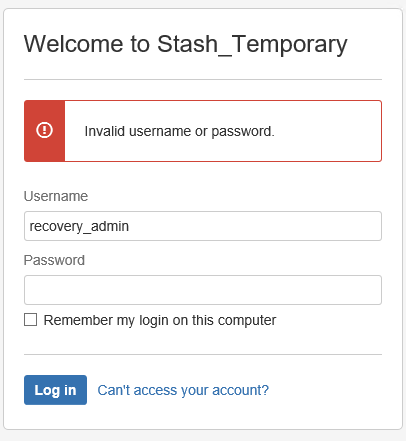

Does this apply to stash 3.51?  I'm trying to upgrade to bitbucket server and going through the dregs of legacy software to do it.  Just managed to lock myself out and need a way to get back in or reinstall the dummy stash server I'm using for the migration/upgrade.
I followed the directions, but recover_admin and my temporary password don't seem to have any affect when applied as shown.  Is there an additional step besides restarting stash?

Do you see on the server that the java process actually picked up the setting with recovery mode?
Anton
Joshua White
March 3, 2021
What would I see that would indicate that?  I don't think I've seen any change in the server behavior.
I'm have another outstanding issue that is being worked on which is related to java calls not being executed properly, maybe they are related.
