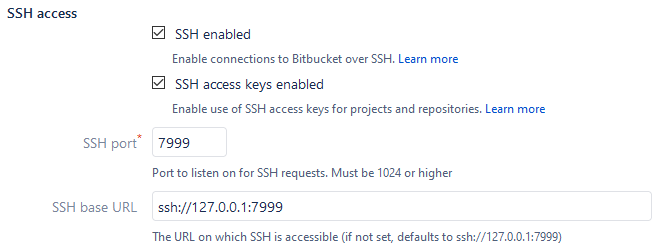

However, 5701 (hazelcast.network.multicast.port), and 7999 (plugin.ssh.port) are still listening on all addresses.

As for 7999 or Bitbucket SSH access, below are the settings from my BB server settings screen.
We are only running a single instance of Bitbucket Server, Jira Server, Confluence Server, and Crowd Server with no plans of using the clustering features of the Data Center version for now.

This was resolved with Bitbucket release 7.11 following implementation of suggestion BSERV-12764
Bryan Turner added a comment - 26/Feb/2021 1:19 AM
Bitbucket Server/Data Center 7.11.0 will add a new property, plugin.ssh.address, which can be set in bitbucket.properties to control what address (or addresses; a comma-separated list is supported) SSH should listen on. The default behavior of listening on all addresses remains unchanged. To bind only to localhost, add plugin.ssh.address=127.0.0.1 to bitbucket.properties.
