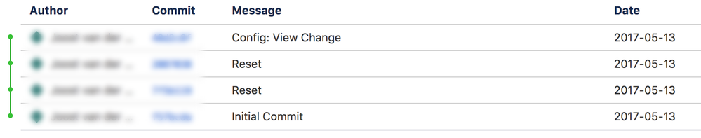

The force didn't do what I expected, on bitbucket I have 4 commits with the last one on the 13th of may. So by force pushing it didn't push my last commit but it somehow removed a few commits.

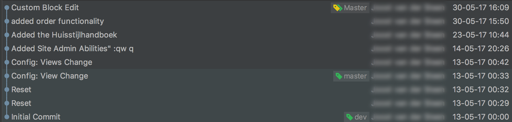

This is my local log in my phpstorm editor:
And these are my commits in bitbucket.Schermafbeelding 2017-05-31 om 20.42.51.pngAny idea on how to get them synced again?

All your recent commits are on Master, but you're pushing master. The capital M makes a big difference here.
Joost van der Steen
May 31, 2017
Aha, and how do I solve this issue? Can i get rid of the double M/masters? And sync to bitbucket again?
jredmond
May 31, 2017
Based on the phpstorm snapshot, you should be able to do a fast-forward-only merge from Master into master, then push master and delete Master:
git checkout master
git merge --ff-only Master
git push origin master
git branch -d Master
