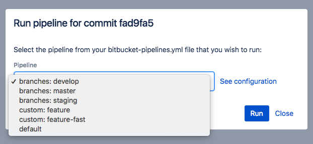

I added two custom pipelines in order to manually trigger them: One for deployment to test and the other for deployment to prod.
Unfortunately, it is possible to run both pipelines on every branch, e.g. I could run "deployment to prod" on the development branch, which should only be possible on the master branch.
Is there a way to limit custom pipelines to specific branches?
