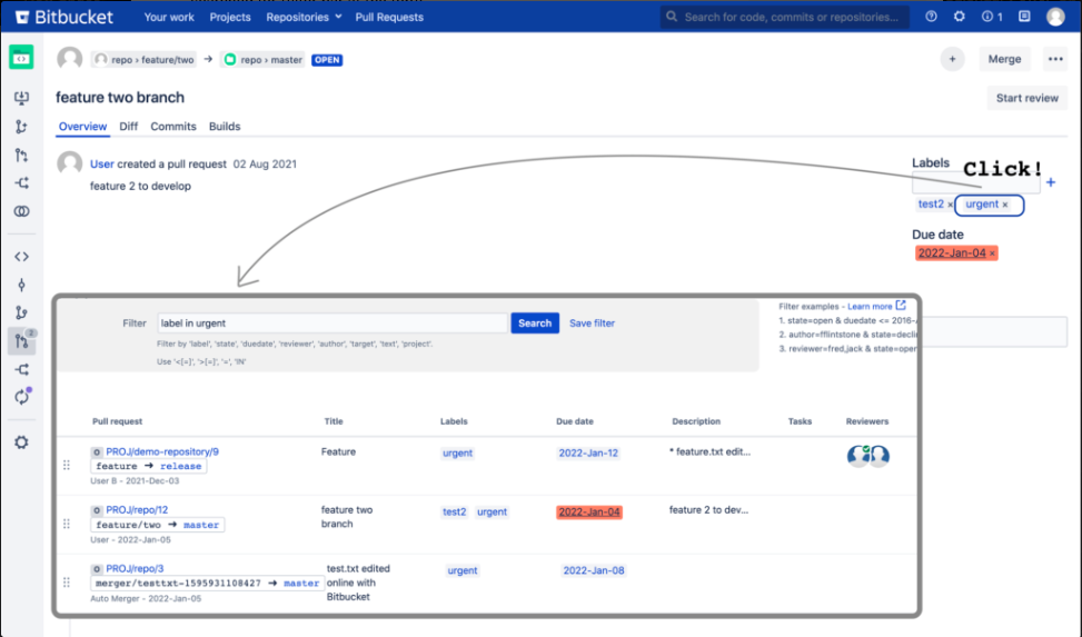

Hi Akota!
It is certainly possible to add a label to pull requests via rest API. You may be interested in one of our apps Organizr for Bitbucket!
Organizr will allow you to view and search by pull request 'label(s)', 'state', 'duedate', 'reviewer'(s), 'project', 'target' branch(es), any 'text' and 'author'(s) - for example "state=open & duedate <= 2016-Aug-23 & label IN (release_1, urgent) & text ~ junit" across the entire Bitbucket instance.
Here is an example of how labels are displayed and how they could be searched for (filter bar at the top);
Here is a link to labels API spec
Line 242 of the source file in izymes-support organizr-public-apis
If you would like to suggest any additional functionality or need other support, we would love to hear from you
Happy Coding!
Sean
