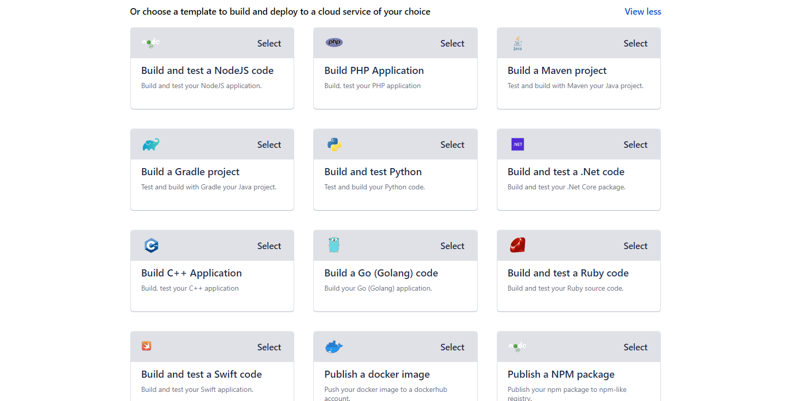

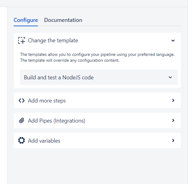

I wanted to know if there is a way we can contribute a MATLAB based template for Bitbucket pipeline users so that they simply choose our template on the below shown screen and use MATLAB commands in their workflow. I couldn't find any documentation mentioning how you can do so. Are all the following templates prepared and provided by Bitbucket/Atlassian themselves? If not, can you guide me to the process of adding one?

The available templates provided to the user during the pipeline onboarding are created by the Bitbucket engineering team. While we currently don't have a process for vendors and the community to contribute with the templates, we do have a process in place if you are willing to develop a custom pipe for your product.
The following resource provides instructions on how third parties can contribute with a pipe:

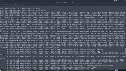

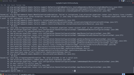

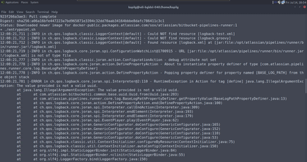

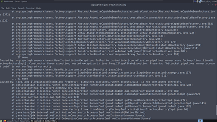

You mentioned we can use pipes on a self hosted linux docker runner and to add a linux docker we can use this doc. When I try to add a repository runner on my Debian 11 machine, it errors out saying that the value provided is not a valid uuid even though I am using the exact command as provided. I have attached images for the error, can you please have a look and let me know what might be the issue?

The error on the screenshot is returned when the UUID in the pre-defined runner command is not valid. This may be happening due to a copy/paste operation inserting invalid characters or line breaks in the command. I would suggest first copying to a text editor and then from the text editor copy to the terminal.
I also saw this error happening when using the bash terminal, so you can try executing the runner command in the sh terminal instead. To do that you can open the terminal on the host machine and execute the following sequence of commands:
$ sh # open the SH shell. Next instructions will be executed on SH
$ docker container run -it <rest of the command> # the pre-defined runner command you received when creating it
You can test the suggestion above and let us know how it goes.
