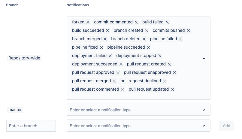

chare
June 8, 2020
Open the repository
Open Repository Settings
Open Chat Notifications
- if you don't already have a subscription configured, then you need to do that first
Configure the notifications you want, like "pipeline failed"Screen Shot 2020-06-08 at 11.00.57 AM.png
ktomk
June 8, 2020
@chare Yes that dialog, unfortunately there is no differentiation between the type of a pipeline possible, e.g. only failed custom pipelines.
