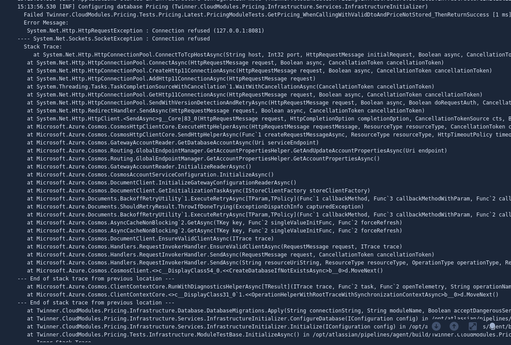

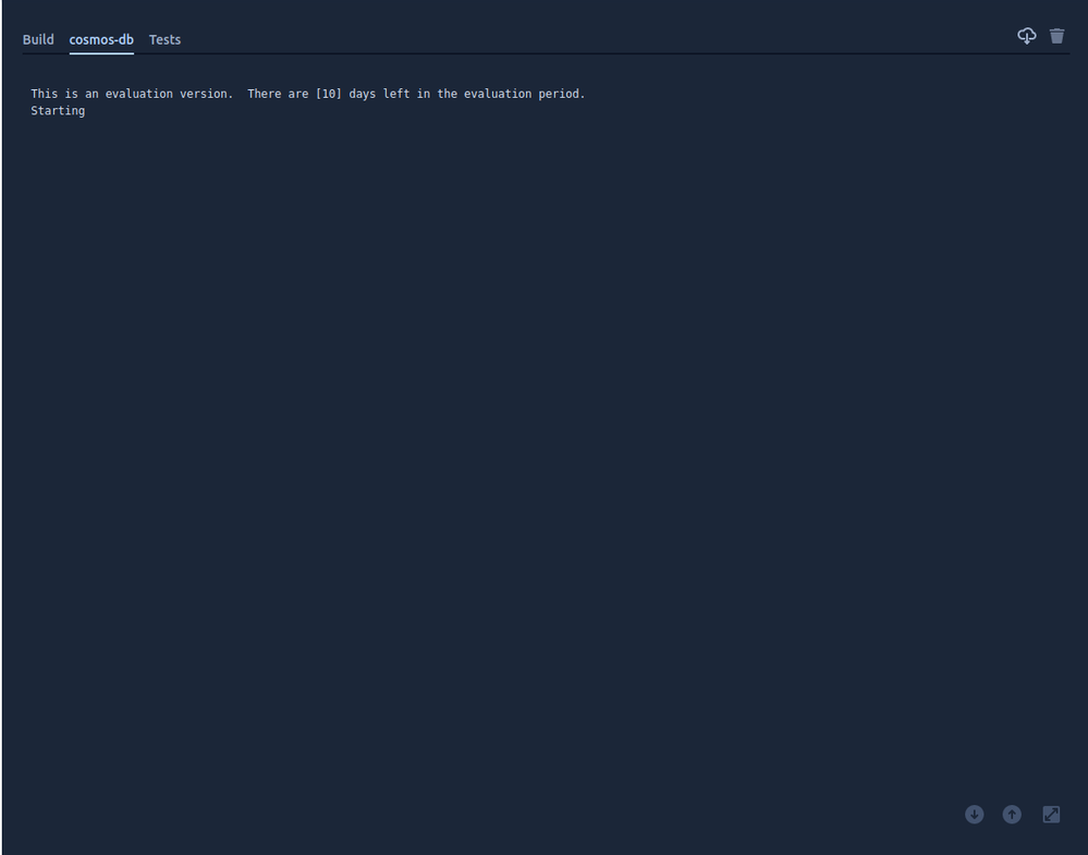

The result of it, is that connections are refused and consequently  tests fail. As side note, the cosmos db tab  - during the execution - seems stuck, it hangs and  shows "Starting".

Questions here are:
Is the service correctly configured? Does the connection string point to the right address?
Is cosmos db emulator supported by the pipeline?

In the beginning, I was seeing errors in the output of curl. Services in Pipelines have no mechanism to wait for service startup, so I added the command sleep 30 before the curl command, in case the service needed more time to start up, but I was still seeing a "Connection refused" error.
I checked the documentation here https://learn.microsoft.com/en-us/azure/cosmos-db/linux-emulator?tabs=sql-api%2Cssl-netstd21 and I saw that 3 GB of memory is required for the service container, so I adjusted the memory used for the service in Pipelines. After that change, and with a sleep command at the beginning of my script, the curl command started succeeding.

I would suggest trying to run your build by allocating 3072 MB to the service (as above) and also adding a sleep command at the beginning of the step.
Instead of using a sleep command, another option would also be to write a script that checks if the connection to https://127.0.0.1:8081 succeeds. If it does, exit the script so the rest of the commands in the step's script are executed. If not, use a sleep command for e.g. 10 seconds, then try again (e.g. 3 more times) and if it fails after these 3 times, then exit the script with exit code 1 so that the build fails and doesn't continue.
I would also recommend using size: 2x for the step, if you allocate 3072 MB of memory to the service. Regular steps (without size: 2x) have 4096 MB of memory in total. The build container is given 1024 MB of the total memory, so the remaining memory for a regular step is 3072 MB. If all of that is given to the service container, then there may not be enough memory left for the build to run.
With size: 2x the step will have 8192 MB of memory in total. The build container is given 1024 MB, we allocate 3072 MB to the service and the rest remains available for the build. Please keep in mind that 2x pipelines will use twice the number of build minutes.
