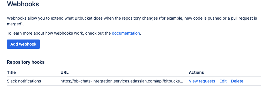

The only way I saw possible for doing so is using webhook related API calls, for example:
curl --location 'https://api.bitbucket.org/2.0/repositories/<workspace>/<repo slug>/hooks' --header ....
--request POST
--data '{
"description": "Slack notifications",
"active": true,
"events": ["pullrequest:created"]
But then this is the outcome:

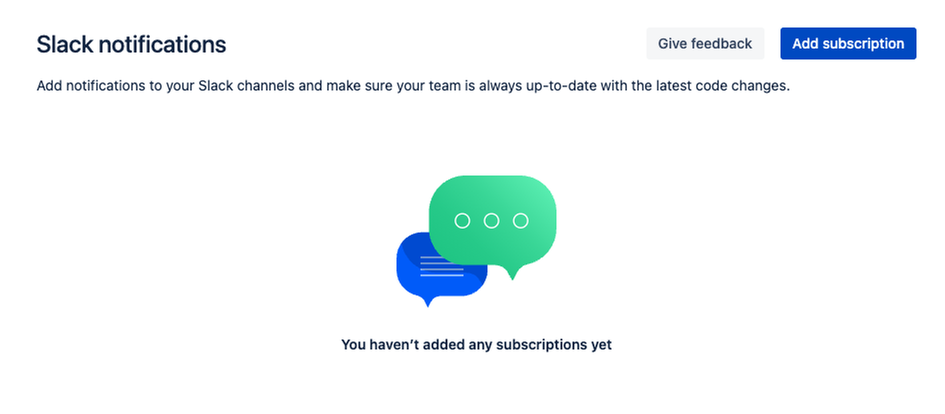

While in the documentation it's a completely different settings section and configuration process:image.png
The behavior I would like to achieve is to configure using the API what you call a slack integration (the picture above), and not a webhook directing to slack.

Unfortunately, you are not able to configure a Slack integration over API which would not just be a regular webhook.
Refer to this documentation to install the Slack integration, this will allow you to configure which events would trigger a Slack notification:
Essentially you would go to Repository Settings > Slack and then click the Add Subscription button on this screen.
This integration is still a webhook, but does not require manual setup like you would with configuring other webhooks.
