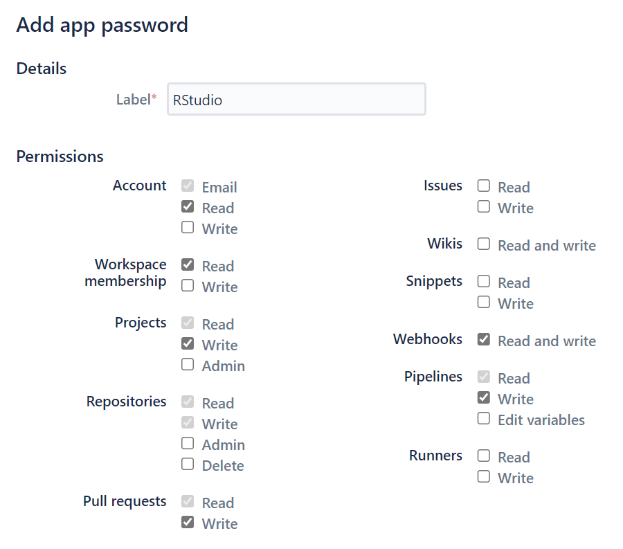

Hi Patrik, thanks for your reply! I just created an app password and gave it the following permissions. Now it says:
cannot open URL 'https://api.bitbucket.org/2.0/repositories/myorg/afp.data/commit/v0.2.2'
The error message seems a bit different but I'm not sure if it's relevant...
Patrik S
May 15, 2023
Hello @Charith Wijewardena ,
Thank you for sharing the results of the testing.
I suspect that R is not propagating the credentials for authenticating the request to download the dependency of your dependency (afp.data), which is causing the error you reported.
I would suggest trying to provide the credentials as environment variables as per what is described in R's install Bitbucket documentation. You would need to create an env variable BITBUCKET_USER with the value of your bitbucket user, and BITBUCKET_PASSWORD with the app password you have created. Maybe with the credentials set on the environment level, they will be propagated when trying to download the nested dependency.
If that still does not work, I would suggest reporting this issue on r-libs issue tracker.
Thank you, @Charith Wijewardena !
Patrik S
Charith Wijewardena May 15, 2023
Thanks Patrik, it didn't work either so I'll raise an issue or try to work around our dependencies so we don't get that problem.
