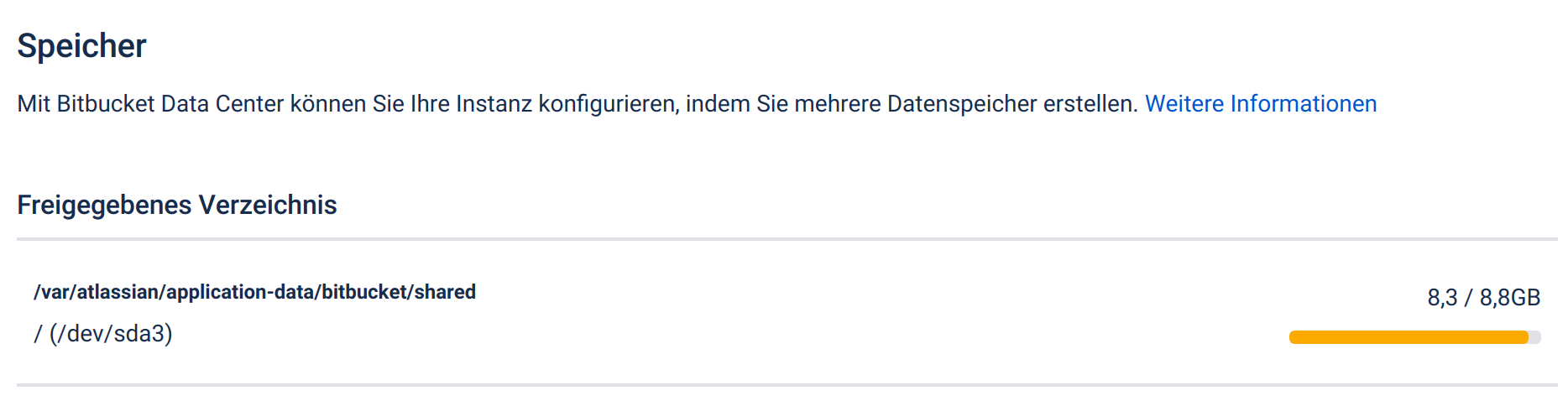

Hey,
I almost reached my max storage space (see screenshot).
So I checked my partitions:

But the storeage is not 'updated' in Bitbucket.

But 'sudo fdisk -l' shows me now 239GB.
