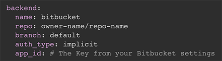

I am integrating Bitbucket with Netlify and Netlify CMS, which uses client side implicit grant to log in and make changes in the repo.
I have set up an OAuth consumer on Bitbucket and have added the Netlify callback URL [ https://api.netlify.com/auth/done ]and the necessary write access to Account and Repositories.
I then added the resulting Bitbucket OAuth key and secret to Netlify settings. I also did the CMS setup.
However, when I then try to log in to the CMS through Bitbucket, I get the error message:
Invalid redirect_uri
This integration is misconfigured. Contact the vendor for assistance.
I saw that on June 5, there was a problem which resulted in this error, but it seems to have been resolved

Update: It appears that instead of the Netlify api callback that I entered in the consumer, the redirect_uri parameter in the URL is pointing to my site.
When I edit the URL parameters manually in the browser to point to the correct callback, things start to work properly.
Any help much appreciated!
