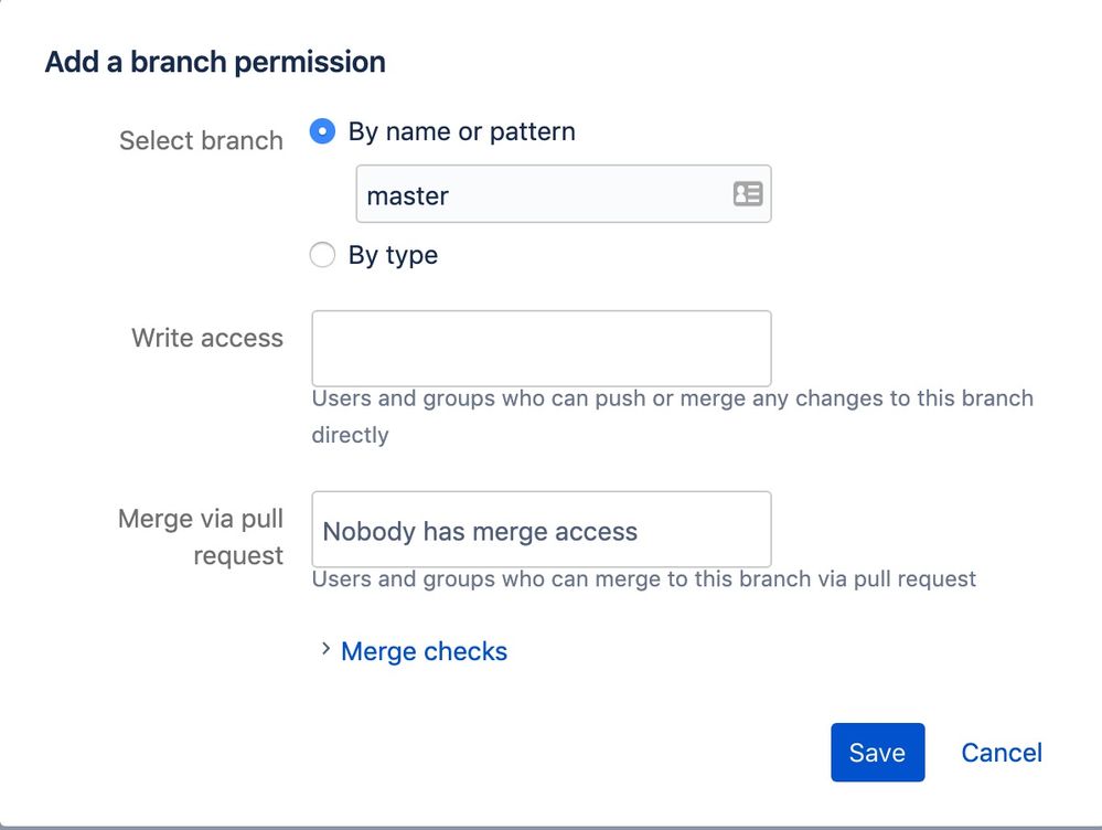

  • In this scenario, you probably need a dedicated account for your pipeline. And you will grant "Write access" permission for that account only. See the UI below for further informatinminhtran83___daily-work-tools___Admin___Branch_permissions_—_Bitbucket.jpg

@[deleted] i suggest you use the ssh key and use ssh:// url instead of http://
With that case, you can easily configured the public ssh key of predefined user that you use to commit code back to master branch and from the Linux instance having that account with the same public ssh key, you can easily commit changes + push back to master
