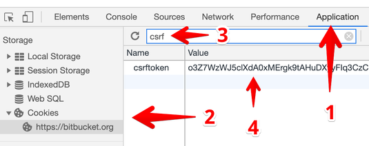

  3. We need to find the CSRF token to authenticate request. It is stored in a cookie called crftoken. In Chrome this is under Application tab, StorageCookies section in the sidebar (in Firefox the tab is called Storage, then Cookies in the sidebar). Note down the value, we'll need it in the next step.

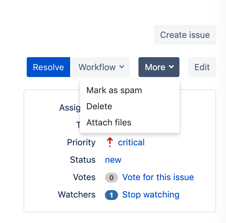

Can you see this? This is a capture on Bitbucket/Issues screen at top of right side.
Thank you.
