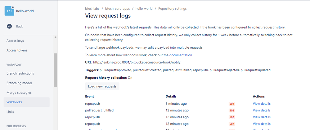

Hello All,
I've configured a Webhook in Bitbucket to integrate with Jenkins.
All the requests fail with 502.
I've added a photo.

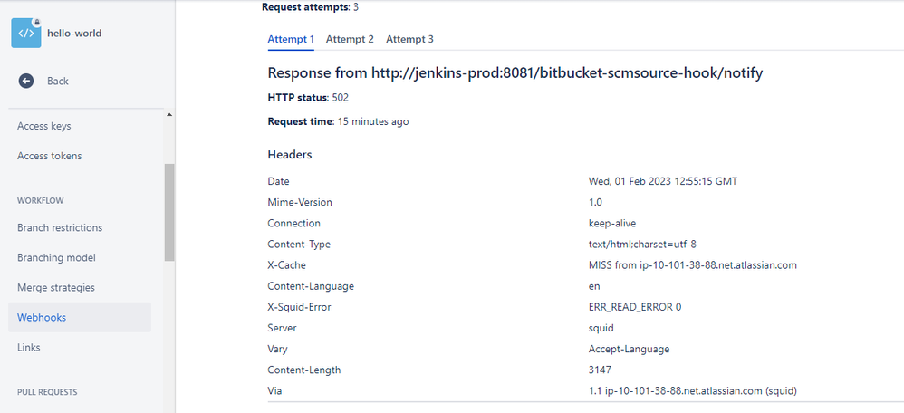

Hi @Mohamed Alaa Awaden and welcome to the community!
I believe the issue is with the webhook URL, jenkins-prod does not seem to be a public domain name but an internal one that you use to access Jenkins from your local network.
You need to use a public domain name that is accessible from the internet or from the IP addresses we use for webhook delivery. In case the server where Jenkins is installed is behind a firewall, you will also need to whitelist the following IP addresses("Outgoing Connections") that are used for webhook delivery:

Hello Theodora,
I found out the root cause. It's because our jenkins machine is not on the cloud.
I've used "Polling SCM" in Jenkins instead to have Triggering in place.

Mohamed Alaa Awaden
February 1, 2023
This an example of One request:
