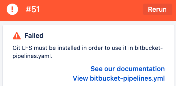

The second pipeline is able to run git-lfs and print out information, but the first pipeline fails during "Build Setup" with the following information:
So for some reason Git LFS works in a step, but not in the build setup.

Hi @Justin Saler and welcome to the community!
I am not able to reproduce the error you get with a configuration as your first step in the bitbucket-pipelines.yml file.
Could you please provide some additional info, so I can better help you?
1. What output do you get if you run git lfs install on a terminal on this Mac?
2. What is the version of Git LFS on this Mac? You can run git lfs version to find out.
3. Does this MacOS meet the minimum requirements for Runners below:
  • OpenJDK 11 (11.0.11 or newer) is installed
  • Git 2.35.0 and above
  • A 64-Bit MacOS instance with at least 8GB of RAM as a host for the runner.
  • MacOS Catalina 10.15+
4. Can you check the runner log and find entries at the time that this particular step failed and post them here (after sanitizing any private/sensitive data)?
5. What is the version of the Runner you are using? This should be in the Pipelines build log, in the first section, Runner.
