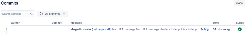

I tested using Squash as the merge strategy and I can see that, if you go to the Commits tab, you will see a part of the commit message, as you described:
However, if you open the commit, you will be able to see the full message:
Could you please confirm if this is what you are referring to?

On the commit message truncation issue, what I'm saying is that the final message is also truncated.  Yes, the Commits view of the repo shows truncated messages to fit a summary into one line, but I'm also seeing the full message being truncated.
It looks like there is perhaps a character limit as I've just seen a commit that has been truncated twice:

the main issue is with the squashed commit message which is truncated.  There is a secondary issue with the fact that the formatting is lost while going through the PR process.  So I think there are two bugs here.

Thank you so much for sharing this repository with us, I was able to reproduce this behavior. Since the bug you mentioned is for Bitbucket server, I created a new bug request for Bitbucket cloud as you can check here:
