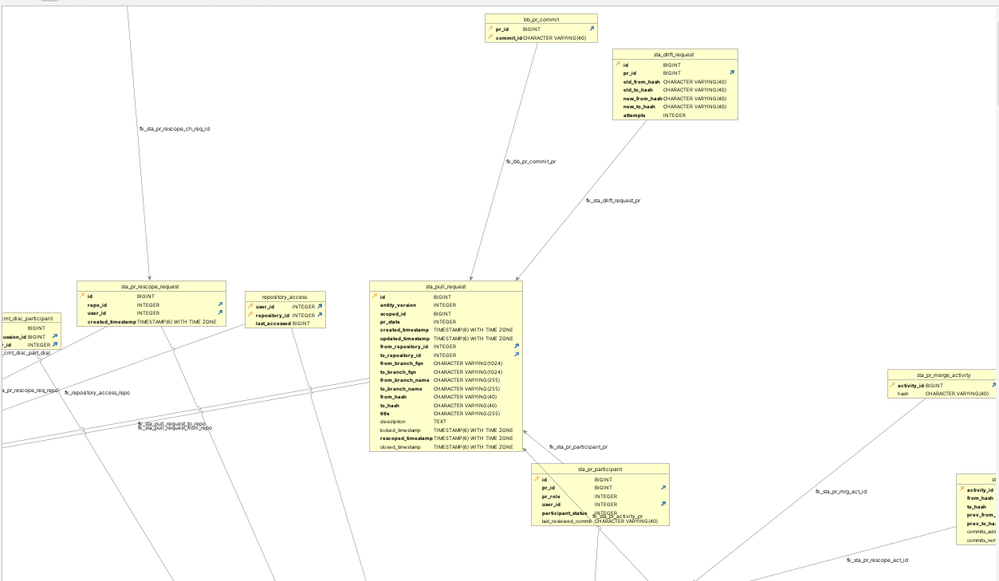

Per Investigating Bitbucket Server Database Schema I downloaded DBVisualizer which has built-in graphing functionality showing a diagram for the Bitbucket database. This at least points me in the right direction.
Screenshot of the diagram in DBVisualizer:
Also see
