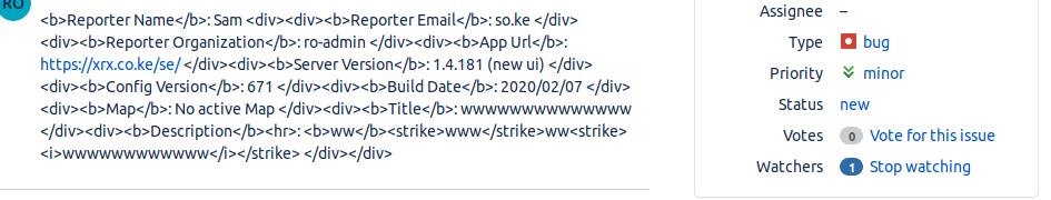

The result for my case is as shown in screenshot below, thanksScreenshot from 2020-02-28 18-55-27.png

I mean, html is never rendered
