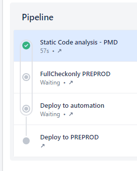

Unfortunately this option won't work this way. Despite setting the requirement for 3 successful builds, it did not bring the intended effect

Oh, think I see what you mean... Is it marking the build as passed once the first step is run, not necessarily when it completes all the steps in the pipeline? You have manual steps?

Łukasz Naporski
February 15, 2024
I would like to force the passage of a minimum of 3 of the 4 steps. So that the ability to merge a feature would only be available after passing the 3rd step minimumbb.pngbb.png
