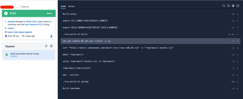

Erez Maadani
April 25, 2023
Here is the visual representation you would have:
You can see each command has its own line so it's very easy to see which one failed.
Basically, each step in the pipeline is running on a different container. if you need to share data between the steps, you would need to use cache/artifacts mechanism or some other way to inject the data into the containers (git clone/ftp/download/etc').
