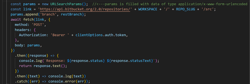

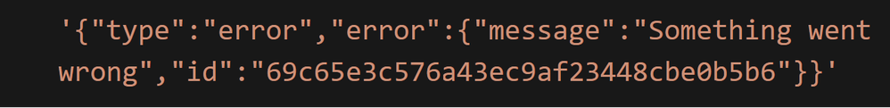

Unfortunately, it still did not work. I tried by implementing the way as suggested by the official API(the node.js example), but still get a HTTP 500 Internal server error.
I logged the execution time in the handler but it always was less than 30 seconds, so I don't think timeout is the issue here. Could you get more information regarding the error from the log IDs below?
Note: In my actual code, the params const is filled with data before performing the POST. Screenshot simplified just for example.

Our backend still reports the same (RequestTimeoutError) however I note that you are performing these queries against a paid workspace. I was not aware of this initially as the email you have used to log this ticket is not linked to such a workspace, my apologies.
As a result of this, I will be raising a support ticket on your behalf and investigating this further - as you have an entitlement to Standard-level support.
We will need your exact commands and further information that would not be appropriate to share on a public forum, so I believe a support ticket is the best course of action here to work towards a solution.
