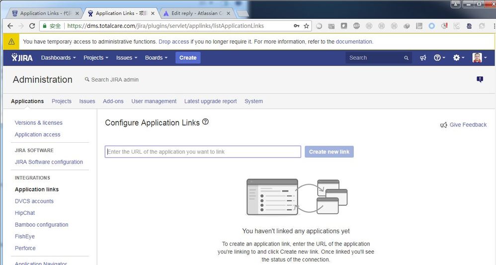

In Jira or Confluence, we can't create Application Link use the url like "https://dms.server.com/jira" or "https://dms.server.com/wiki", the system responds this:
No response was received from the URL you entered - it may not be valid. Please fix the URL below, if needed, and click Continue.

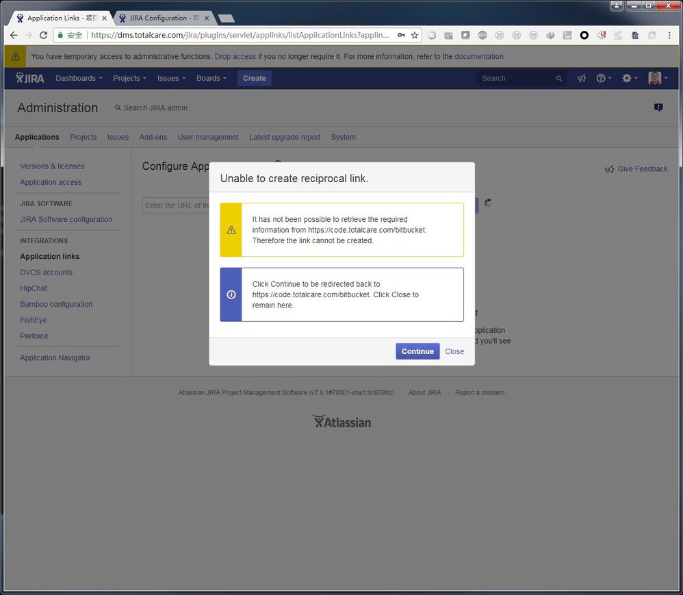

And in next step, Confluence can't auto-create reciprocal link for Jira.
Unable to create reciprocal link
It has not been possible to retrieve the required information from https://dms.totalcare.com/jira. Therefore the link cannot be created.
Click Continue to be redirected back to https://dms.totalcare.com/jira.
Click Close to remain here.

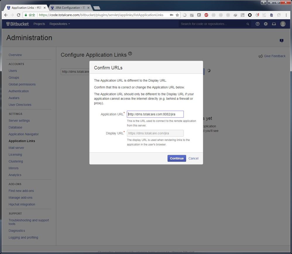

Zamba Lee
April 9, 2018
Thanks for ur help!

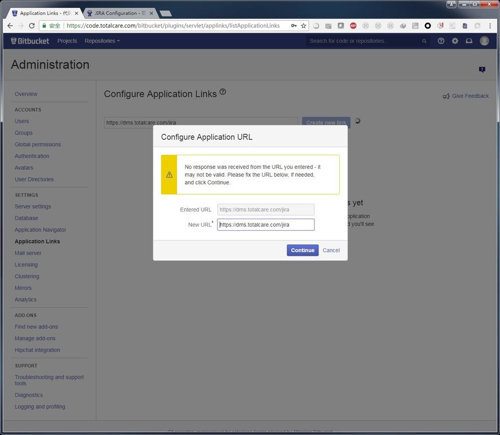

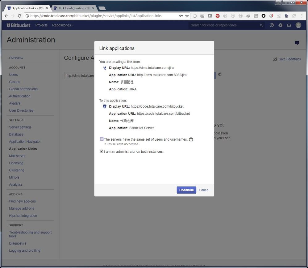

I just tried, but still got the same wrong:
  • Change the Nginx cfg:
  • Restart service of Nginx;

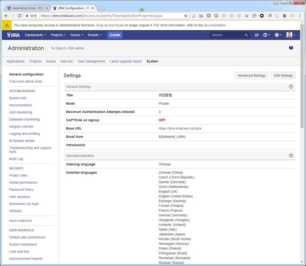

  • Verify Jira base URL
Creat Applink in Bitbucket 2.JPGCreat Applink in Bitbucket 3.JPGCreat Applink in Bitbucket 4.JPG

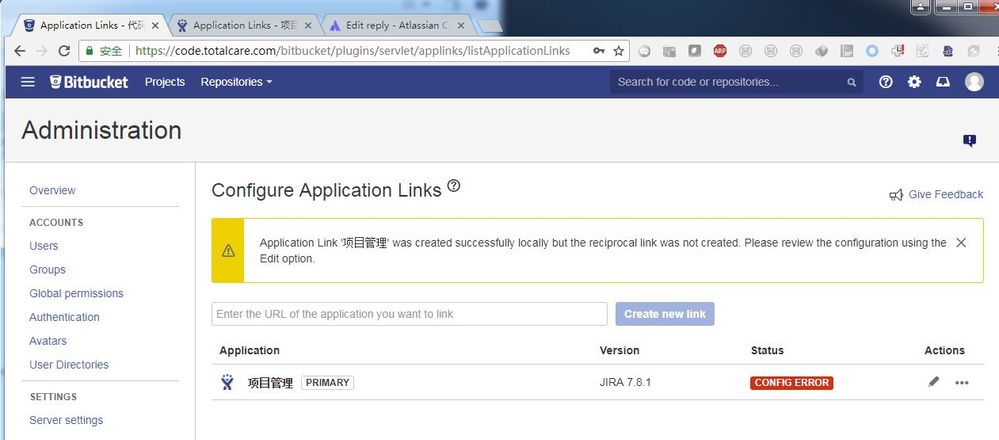

  • Finnal result
Bitbucket have one “Config Error” link, and Jira still empty...
