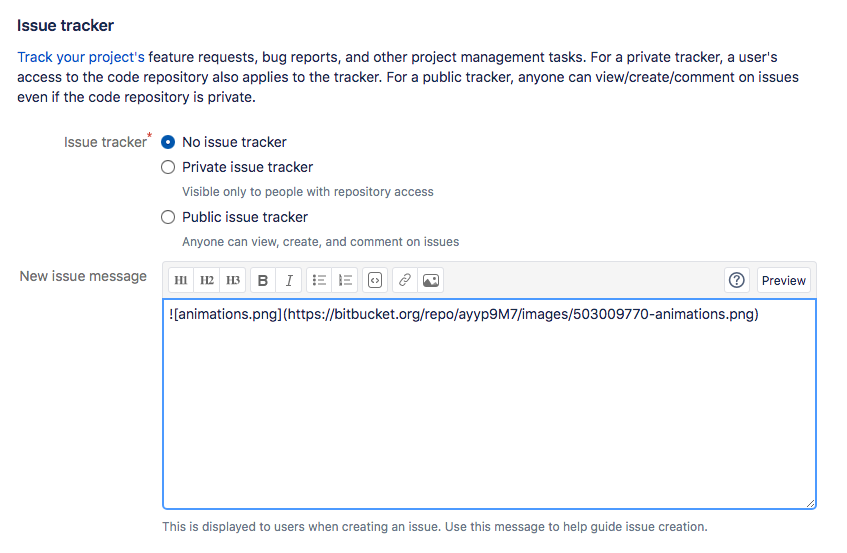

In each repo's Issue Tracker under Settings, I added an image to the "No issue tracker":
That provided a link that I copied and pasted into the repo's Readme.md file. This works for me and is the same technique some use on GitHub.
