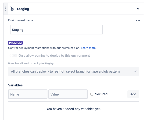

How to add an environment variable to an specific environment using bitbucket api ?
Marcelo_Anabuki
October 11, 2019
This image is what I want to do in the api.
I want to add a variable to an already existent environment on a repository using the api. This is not a repository "global" variable. This is a specific environment variable.(On this environment I am using staging)
From the documentation I found this url that should do the trick, but I have no idea how to use it to achieve what I want.
/2.0/repositories/{workspace}/{repo_slug}/environments/{environment_uuid}/changes/
