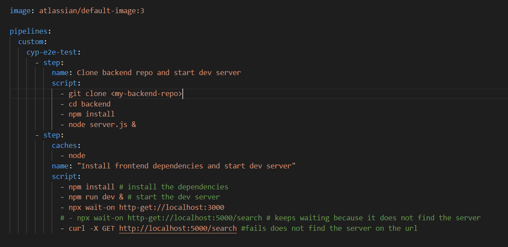

I want to start a backend node.js server in step 1 of my pipeline (port 5000); and from the second step of the pipeline, I want to call one of its public endpoint.
The scenario:

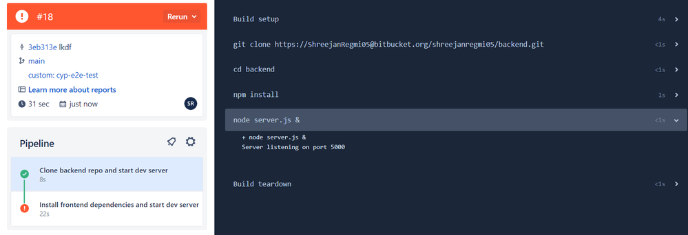

I have two repos, one for frontend, and the other for backend. The yml file is present in the frontend repo and I have made all configurations in bitbucket to provide my frontend pipeline the access to clone my backend repo, so all good on that. The server also starts fine on the first step:
My YML:

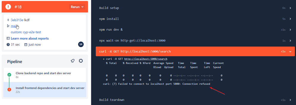

In the second step, when I curl GET the public endpoint e.g: http://localhost:5000/search, I get the error:
curl: (7) Failed to connect to localhost port 5000: Connection refused
Screenshot:
I think this is because when we get to step 2 the build in step 1 is already torn down so the server is not available?
How can I access the endpoint in second step so that the curl request passes?

Pipelines builds run in Docker containers. For each step of your build, a Docker container starts, the repo is cloned in that container, and then the commands from the step's script are executed. When the commands finish successfully or if a certain command fails, the Docker container gets destroyed.
What you are asking is not possible because the Docker container from the first step no longer exists when the second step runs. You will need to start the server in the same step where you want to use it.
Please also keep in mind that if you clone a different repo in the first step, that clone will not be available in the second step. You can make use of artifacts for any files that are generated or downloaded during a step if you want them to become available in subsequent steps:
