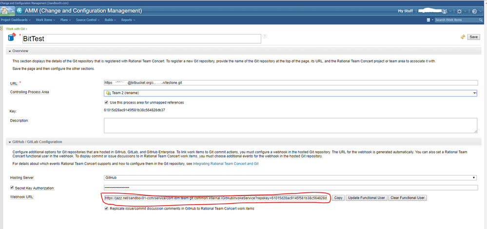

I am using Rational team concert v6.0.6 from opensource jazz.net and using the opensource Bitbucket provided by atlassian.
I am trying to configure RTC to use the Bitbucket repository (RTC can integrate with Github)
I am configuring the Bitbucket repository in RTC and from that i am using the webhook url
When i am configuring the Webhook in Bitbucket, i am not having a option to add the authentication details of RTC, I used App password for the same. but didn't work.

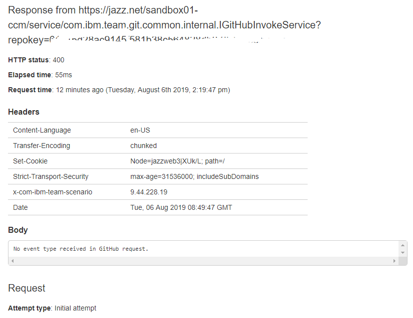

for any trigger event in Bitbucket, i am getting the below error.
Can anyone please let me know that the integration with RTC is possible or not?. and if yes then can you please route to the relevant documentation or please let me know the steps.

I don't know anything about IBM Rational Team Concert, but from the error message it returns I'd guess it expects GitHub payload format, not Bitbucket (which is different). I believe this is because you selected GitHub in the Hosting Server dropdown. Bitbucket isn't mentioned in the config section description, so maybe it isn't supported?
