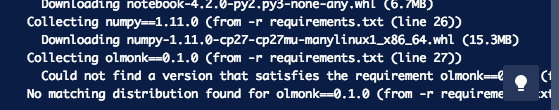

We have packages from our internal pip server that are used in the repository. How to install these packages while running the bitbucket pipeline.
Please find the attached screenshot of the error shown. Screen Shot 2017-08-17 at 7.57.44 PM.png

Hello,
Is your internal pip server somehow accessible via the public internet?
Here's how you can add a private git repository as a dependency. Maybe this can get your started on the right track? https://stackoverflow.com/questions/4830856/is-it-possible-to-use-pip-to-install-a-package-from-a-private-github-repository
