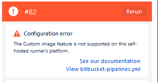

Is there a way to configure my Pipeline with a selfhosted-Runner to only manually run my Pipeline?
According to https://support.atlassian.com/bitbucket-cloud/docs/pipeline-triggers/ I have to define a custom Pipeline for this. But then my Pipeline displays this:
My Test yaml code looks like this atm:

If I change it back to "default" it works fine.

The error is not referring to the use of a custom pipeline, but to the use of the image in the step:
image: mcr.microsoft.com/dotnet/sdk:6.0
Based on the runner label, I assume you are using a Windows Runner? Windows Runners do not use Docker and the builds do not run in Docker containers. They use PowerShell to run pipeline steps on your Windows machine (host device). The image definition makes sense only for Pipelines builds that run in our own infrastructure or in a Linux Docker Runner.
You need to remove the image definition and this error should not occur then.
Running a custom pipeline via API is also possible, as long as you remove the image definition:

Jonas Augustin
May 19, 2023
Thank you very much Theodora!
That fixed my Problem😃
