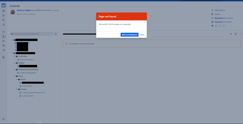

I can see all the details of the commit behind the error message except inside the code diff window where it just says "An unknown error has occurred". I have enabled logging and couldn't see any errors and Diagnostics doesn't show anything.

Hi Ana,
Yes, I'm using Bitbucket Server 6.0.0 (Build Number: 6000000)
The error happens from the following scenarios:
- Viewing a commit
- Viewing the "Diff" tab on Pull Requests
- Viewing the "Diff" tab when comparing branches
