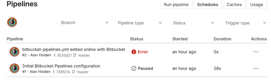

So I thought I had followed the Getting Started instructions to create my first pipeline.
But now the UI for this creation is filled with red error icons, and messgaes read as though I had intended my first one to affect our master repo. Definitely not my intention.
So, how do I simply remove this malignancy and go back to the days where I never "Got Started"? I just want to begin again, trial and error, without consequences like this.
TIA, AL
HOW DO I DELETE THIS CRUD?

Alan Holden
July 14, 2026
Thanks @Ajay _view26_ for the response!
There was no  bitbucket-pipelines.yml file in any branch, so I created one and placed this minimal config inside.
image: atlassian/default-image:3
pipelines:
default:
- step:
script:
- echo "Pipeline configured"
I'm not sure if I'm technically back to square one, because the items listed in the "Pipelines" page are still there... and pipelines was enabled back then.
Before I "Got Started", there was nothing here... or there.
But at least the red complaints have stopped... and I'll always have this lifelong reminder of something I probably should've paid someone else to do - rather than believing it was easy - and that a little "tinkering" would be easy to undo ;-]
Does anyone know why BitBucket would assume I wanted to kick off my first newbie attempt under our master production branch, rather than asking me first? Are all Pipelines supposed to go there alone?

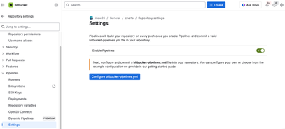

Ajay _view26_
July 14, 2026
Hi @Alan Holden
You’re right to pause here, and I should clarify one important point: creating a `bitbucket-pipelines.yml` file is not the way to get back to square one.
If you want Pipelines fully “off” again, remove that file from the branch where it was added and disable Pipelines under **Repository settings > Pipelines > Settings**.
The entries already shown on the **Pipelines** page are pipeline history/status records. They can remain visible even after you remove the YAML file or turn Pipelines off, but they don’t mean a pipeline is still configured or actively doing anything.
On the branch question: Bitbucket isn’t treating `master` as special for Pipelines because it is “production”; it is most likely using it because it is your repository’s default branch, or because that is the branch where the setup flow/config file was created. Pipelines can run on any branch that contains `bitbucket-pipelines.yml`.
